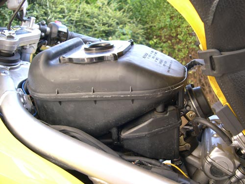

Step 1 - Airbox removal
Remove front seat, remove two bolts at the headstock that hold the fuel tank down, prop tank up with tool provided under rear seat, exposing the air box.
Dissconnect both breather pipes from the air box, use long nose pliers to move the clips. With a firm tug of the air box, this should free the box exposing the carb below.

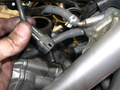

Step 2 - Fuel Feed & Throttle Position Sensor Disconnect & Idle Cable
I found that it was easier to remove various Fuel/Sensors/Idle Cables, so that access to the carb covers is easier. The idle adjust knob has to be uncliped from its holder on the left side of the bike.
Disconnect Fuel Feed
Disconnect Throttle Position Sensor

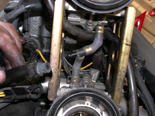

Step 3 - Slacken intake duct clamps / Carb removal
To gain easy access to the front & rear carb covers we need to remove the carbs from the engine intake ducts.
Rear carb - Between engine & Carb
Front carb - Between engine & Carb, Radiator needs to be moved to access clamp.
Once both the intake duct clamps have been slackened then pull the carbs up by the gold side bars and move to side.

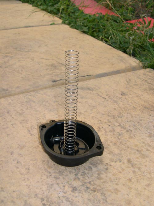

Be very carefull not to let any of the spring fly off in this section

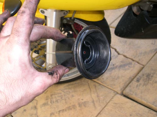

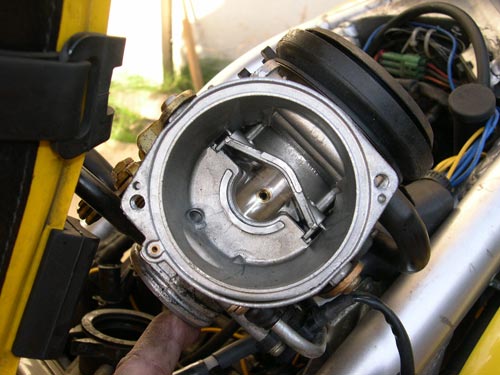

Remove the two screws holding the black cover on the carbs.
On removal of the carb cover you will see the diaphragm & piston assembly, remove this carefully so not to damage.

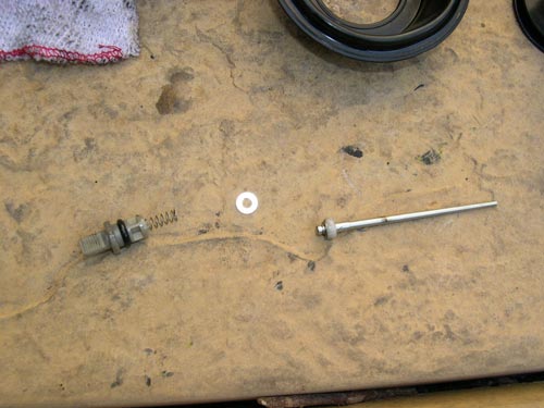

Remove the Jet needle from the piston, as you look into the end of the diaphragm & piston assembly you should see a small grey retainer. Using a long nose pliers, pull and remove. (Becarefull because there is a very small spring and washer that will come out.
What the Jet needle set should look like.

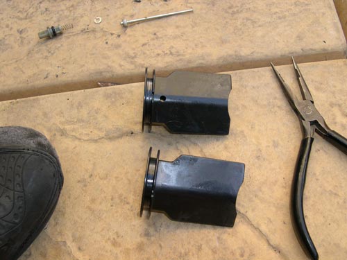

Remove the diaphragm from the plastic piston, very carefully so not to damage. As you can see in the picture of the pistons without the diaphragms, the one on the top is the restrictor (with the small hole at the base) the bottom one is the original one which will give you full power.
