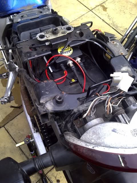

With the control installed, red for down green for up, the wire was fed back through the bike following the choke cable and alternator wiring routing to the control box that we mounted under the pillion seat.
The control box is fused and wired directly to the battery and accepts plugs from the switch and the actuator. There is an additional access point for ignition interrupts if using a quick shifter, but we haven't got one fitted here.
Finally an additional wire was required to be soldered into the ignition circuit on a positive feed to ensure the gear change can only happen when the bike is switched on. As I'm not a wiring expert and my soldering is far from the best we opted for the brown rear tail light wire. Though please suggest a better wire to go for as this is intended to be changed?
So with that the bike was fired up and after a bit of adjustment we had the system changing gear on the button. There is still a little more work to be done to prepare the bike for teaching on the Bike Experience but the main point of accessibility is now on and working.

Wiring? usual feed for live when bike is switched on is sidelight or rear tail light so I reckon you're ok there.

Yes, thats the basic of it. The set up pictured has the actuator in the rest position which is halfway between is maximum and minimum stroke.
It's a bloody waste to set that up without quickshifter. Does it have function inbuilt or is that another add on?
I believe it has the function inbuilt. The yellow wire coming from the control box that is unused in our installation is listed as the interface wire for an ignition interrupt.
"A little enthusiastic?"
SH2 | 2MA | GROM | YSR
Old 29-05-11, 11:35 PM   #7
Default Re: Fitting A Kliktronic Gearchanger
it could be for ignition or it could be logic trigger for a separate unit. I would have expected 2 wires TBH unless you are meant to feed that out to coil positives. Check in instructions.
