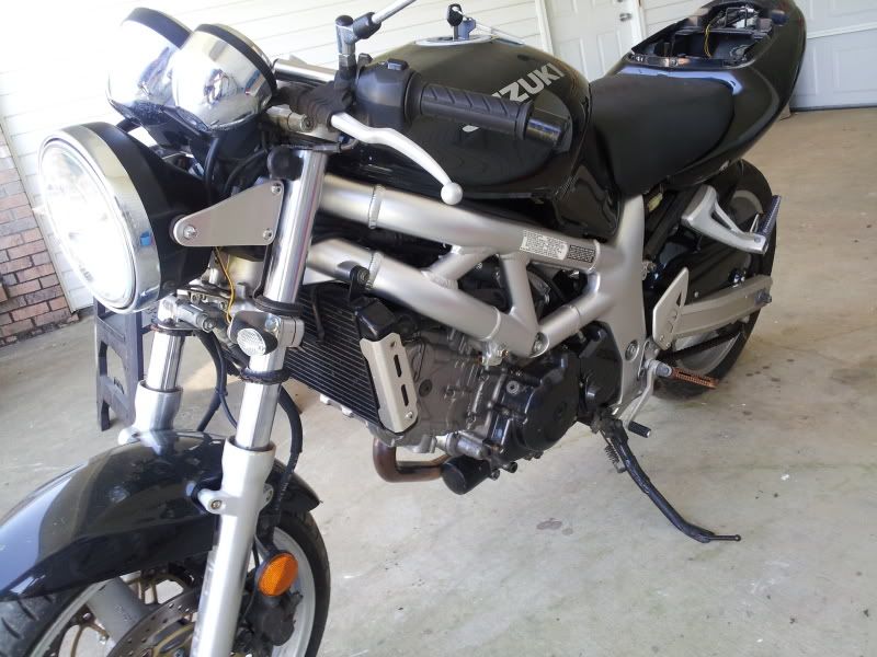

Hey everyone, just picked up a 2002 black sv650 and am now working to figure out what to fix, and in what order.

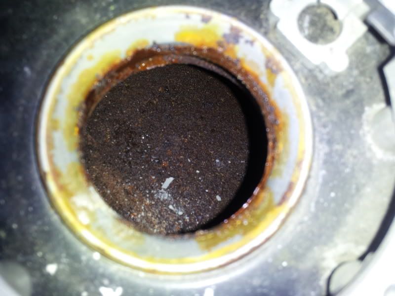

It was a one owner bike that sat in a shed since 2006 without any storage prep. Needless to say the tank is pretty rusted, and the fork seals are dry rotted out.
I'm looking for some advice on what to look for while fixing it up. For the tank, I got some rust dissolver and will probably do something like POR-15 if it isn't too damaged. Otherwise I'm open to suggestions. Thanks!

post some pics up, lets see how it look first!

Fork seals totally gone
Pretty bad rust in the tank, I dropped it off at a shop today to be cleaned so hopefully it will be salvageable...
Carbs out for cleaning
I was actually suprised by how clean the carbs were. There was no gas in them so maybe the PO drained them out before he parked it, I dunno

The overall condition looks a lot better than mine

Stanchions look suprisingly fine. If you save that tank ill be amazed. Why not build yourself a proper bench?

Are you in the UK?. There is a company here that refurbs tanks and have had ones done in the same condition as yours and they come back as new inside. Costs around £180 though.
+1 makes mine look bad

I'm in the US. I've got my fingers crossed for the tank, been unable to find a used one yet so may have to fork out $600 for a new one. Got the parts ordered for the forks, hopefully have those spruced up next week sometime.
