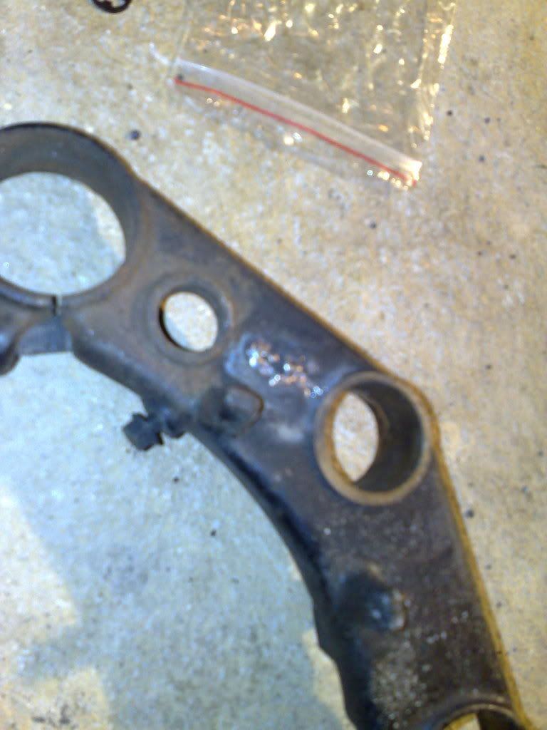

Right didn't think I'd get a chance this week but I put some other things off just so I could have a quick go. So got a plug from Tesco and out to the garage I went. Wired it up plugged it in. Got a rod in the device. Found a hacked up bottom yoke from a NC23 and thought I'd use this for a practice piece.
The set up...

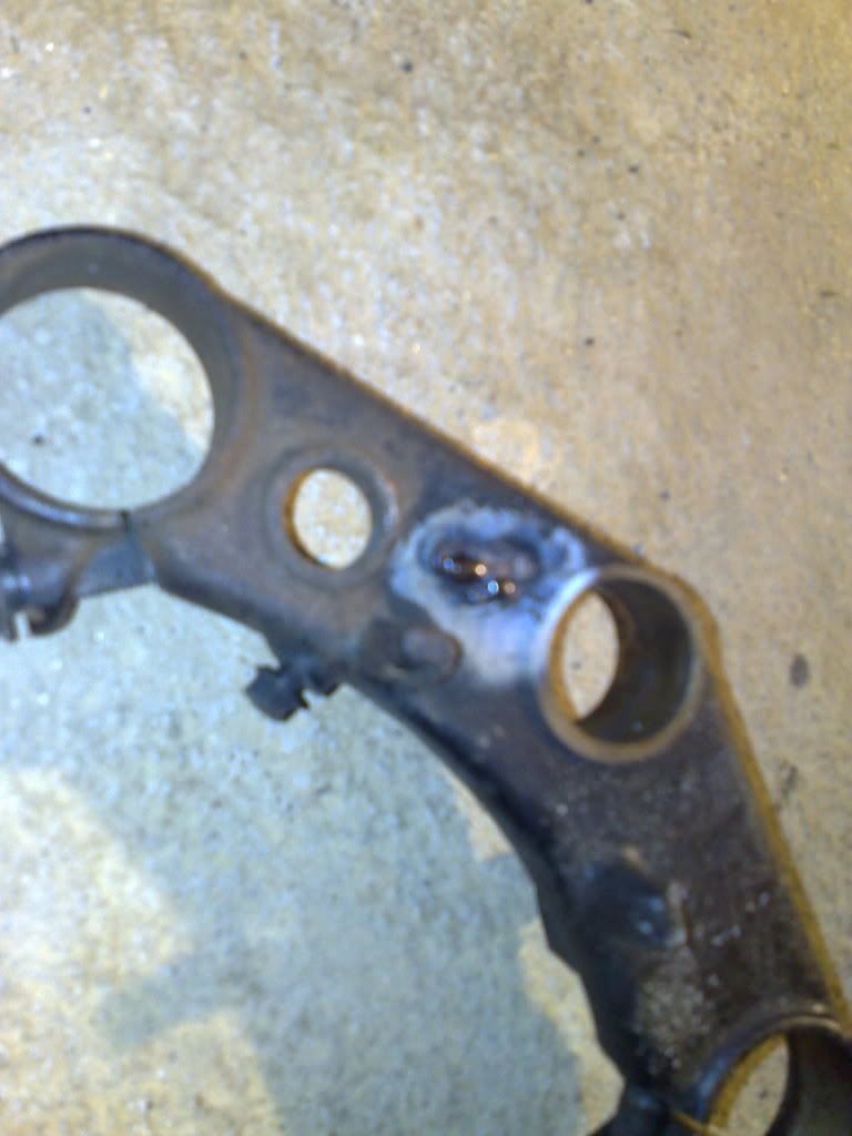

So aiming the rod at the yoke and with everything connected I hold the mask up to my face and bring the rod down to contact. Nothing. Ok, so I start waving it round a bit. Still nothing. Quick check is everything switched on and plugged in; yep. So a try again. Success; a spark "Its alive!". So I put the tools down switch off and go to look at the results. Yes I had a small burn mark on the metal.
This continued for a little bit longer. The occasional spark but no weld. Until I got it to spark and hold it there for a little longer, and this is what I got...

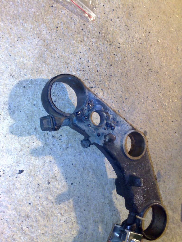

After a few more trys getting it to spark up and keep it going became slightly easier. So I started moving it around adding weld to the yoke until I had fixed a whole rod to the yoke...
At this point I decided to quit while I was ahead. It was way cool, sparks flying everywhere the smell that hung in the air and the smoke coming off of the yoke. This is fun. I let the yoke cool for a bit and then chipped and scraped some of the loose bits from the weld. Admittedly I reduced the amount of weld on the yoke by about 90%, but at least there was some left on it at the end. So I finished the night with this...

Helpful (?) comments on your pictures
Your metal is not clean
It is usually more comfy to have the rod at right angles to the holder
You may need to raise the current a bit
Keep playing!

Also that yoke may have been made from all sorts on unknown quantities but the hardest part you had there was that it was probably painted and the fact that it was also cast .......... cast is hard to weld as it has bubbles in it . Go for a nice big bit of freshly ground plate .
