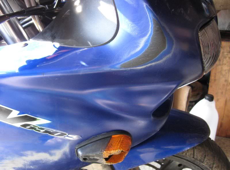

So, out to the garage this morning to have a fresh look at the damage to the bike after yesterdays little prang and.....not as bad as I'd first thought.
I thought this split was a lot bigger than it actually turned out to be.

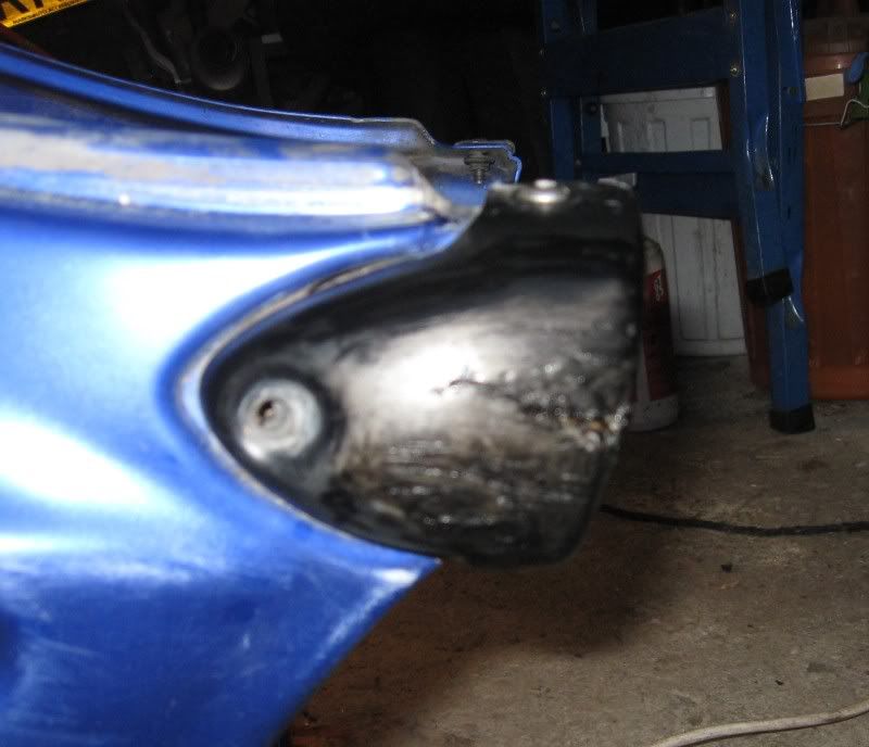

Busted brake pedal and a lump missing from the fairing (I'll just dress the shape of the missing bit so it looks like it's meant to flow around the clutch cover)
Took some wet and dry to the scuffed areas to flatten them prior to priming and rattle can spraying tomorrow.

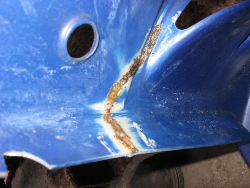

Used a soldering iron and some white zip ties to weld the splits up. It doesn't look pretty from the inside but it's solid.
Outside welds looked better once they'd been gone over lightly with a sanding disc.

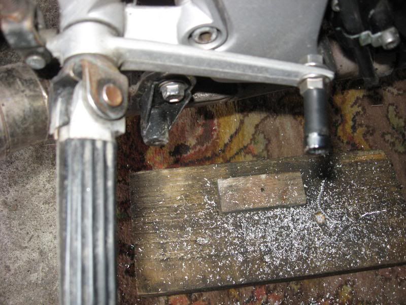

Temporary repair to the rear brake pedal with a chrome allen bolt, two stainless flange nuts and a piece of black rubber fuel pipe.

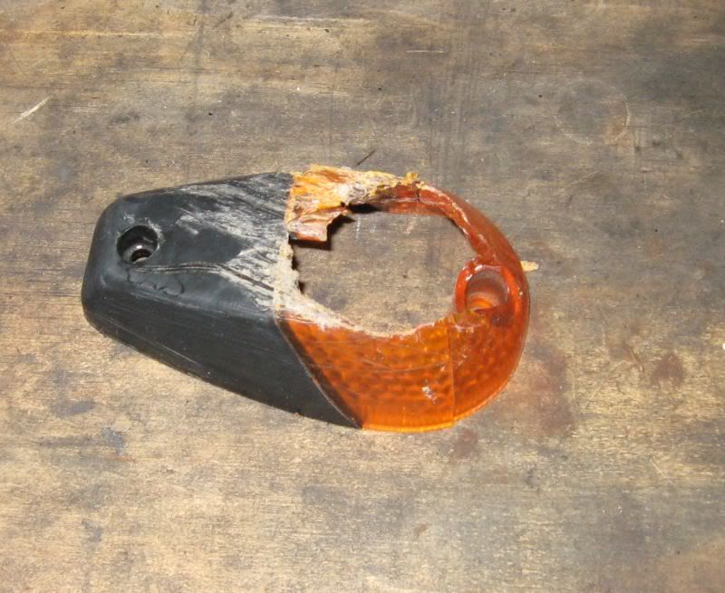

Realised when I started trying to find a replacement indicator lens that the ones on my curvy aren't standard.
Took me a while to find a match but found a pair of identical indicators for a tenner from Busters. Was going to try and find just the lens but the complete pair was so cheap I just went for them. Hopefully they won't take too long to arrive.

The only other thing I shall buy when I can afford it is one of these. They are a bit expensive I suppose, but this is the second time I've busted the brake pedal and one of these might save me from having to stump up for a replacement if I fall off again.

A Fixer-Peg is less than half that & you can transfer it to your next bike.
And the one after that!

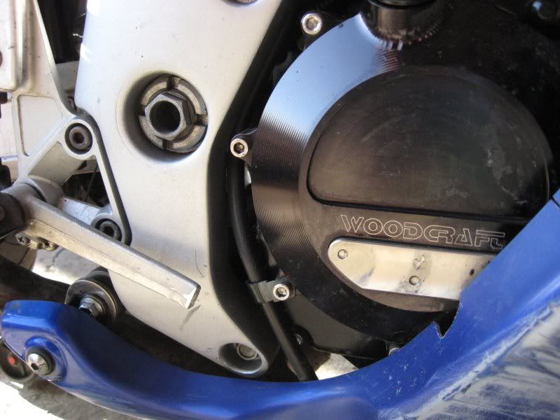

Good job with the tie wraps. At least the clutch cover survived it!
Was just thinking that...
Whats your views on it?
They're damn good clutch covers, well made, robust, and they don't leak. Expensive though....
I know but I do like both the look and the practicality of the fold back brake pedals.
Might I ask what indicators you bought?
I want a set for my curvy SV as the stock ones are;
a) Fuggly
b) broken where i keep hitting them on my door/house/gate/me
Old 28-02-12, 12:12 PM   #10
garynortheast
garynortheast's Avatar
Join Date: Mar 2010
Location: Mid Wales
Posts: 2,689
Default Re: Repairing crash damage
a) Fuggly
They haven't arrived yet. I will probably fit them as the ones on the bike are a bit rusty inside so new ones might be a good idea.
