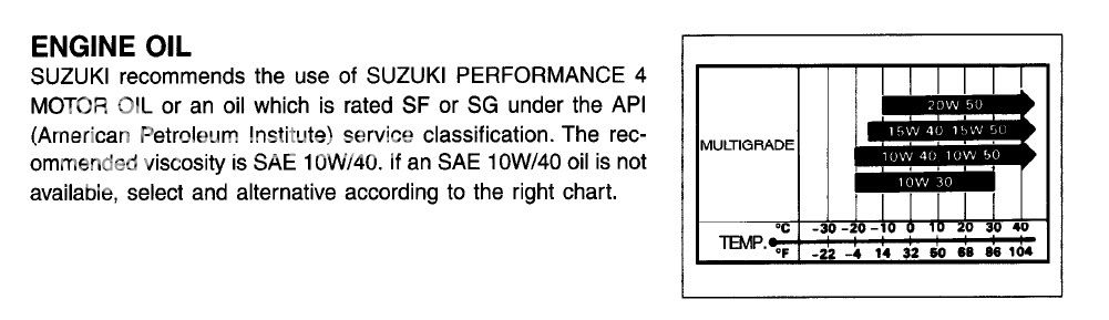

Mines had 4 oil changes in 9k (approx 10l through) I think its burned about 2 litres in that period.
I think DT suggestion could be the way forward and see what it does on that oil. 200- 250 miles between top ups is a lot (roughly 200ml a time sound about right BC, still in the tolerances LP has quoted). If it doesn't improve on the thicker oil, the control rings and bores are very loose (tolerance wise)
Nicked from the Workshop manual to save you hunting

Will thicker oil be ok in my engine? If there's a chance it might damage something I'd rather just keep topping up?
Old 09-05-11, 03:31 PM   #14
Dicky Ticker
Default Re: Oil usage question.
A 20w50 is thicker when cold but hardly likely to affect starting. As the chart shows is compatible for -10 to +40 degrees. Try a 15w40 as Chris suggests first and if no joy go up to the 20w50. Possibly because the weather has warmed up your engine is running slightly hotter than in the winter making your current oil a bit thinner and the crank is throwing it up causing more splash on the bores which is in turn getting past the rings and being burnt off, although not to a degree where it is noticeable in the exhaust I take it you have no oil leaks
Obviously with a fairly high mileage engine it is not uncommon to get increased oil consumption due to overall wear on the rings and bores and not all engines are the same-------BUT,if you can live with topping up every second tank of petrol continue to do so using your current choice of oil,after all it is hardly likely to break the bank and you always have fairly fresh oil in your engine.
